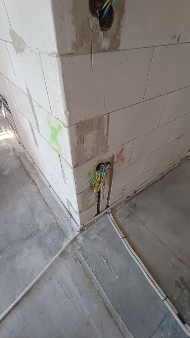

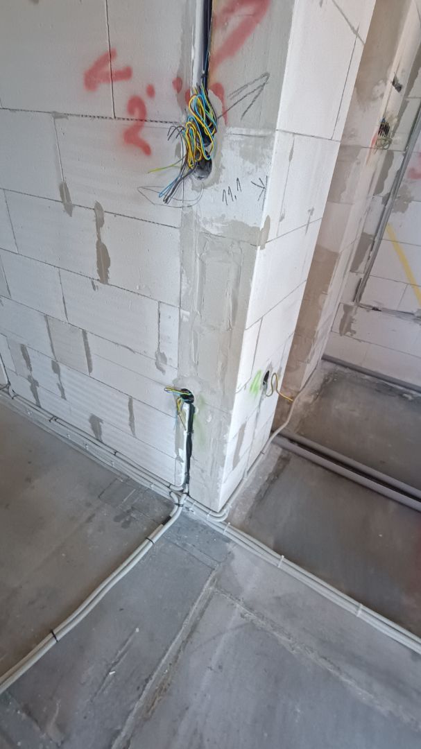

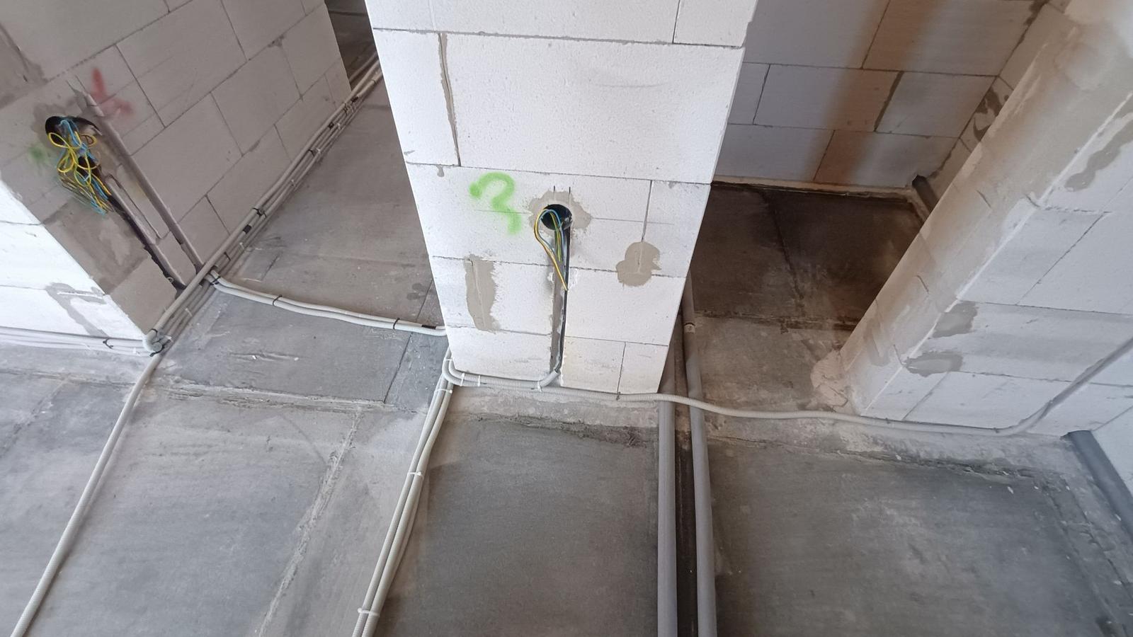

Ja robim takto vo svojom... https://cdn.4nets.sk/48616689_1920.jpg https://cdn.4nets.sk/48616690_1920.jpg https://cdn.4nets.sk/48616692_1920.jpg https://cdn.4nets.sk/48616693_1920.jpg https://cdn.4nets.sk/48616691_1920.jpg
